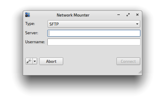

        It looks like KNetworkmounter is the right solution.
        KNetworkmounter
        Mounting Samba,SFTP und NFS Networkdrives is easily possible with KNetworkmounter.
        This application uses the normal mount command to access network shares which makes it possible for every application to use files from the share and not relying on KIO (KDE Input/Output) .

        Has anyone got this to work on Kubuntu? or know how it can be installed? It's not in Discover.
          I just found a deb here:
          https://download.neptuneos.com/repos...etworkmounter/
          knetworkmounter_0.5_amd64.deb
          It runs, but I've not been able to connect to the NAS. It doesn't appear to find any NAS or shares using Samba or any of the other options.
