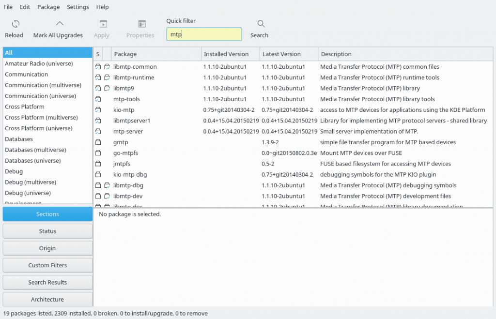

                  Do you have the mtp tools installed?
                  That resolved a lot of randomness that I was having with my tablet connected to my Kubuntu desktop machine.
                    Hmm - everything has had overnight to sit and simmer and ripen.
                    Plugging in my smartphone this morning and no delay at all. As soon as I plugged in the smartphone, it popped up on Dolphin and was working.
                    Maybe the cache is considered current and so the response is immediate?
                      I just installed mtp tools. Do not know if that will make any difference since Dolphin was working with the smartphone directories already because of the difference in the nfs mount options. I'll see what happens in the future. Thanks for the suggestion.
