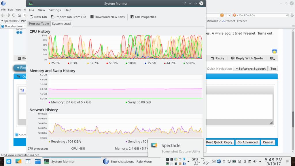

            The pic below shows the activity on my system, which is set to give Java 512Mb and 2MiB bandwidth. Java takes 5% of the CPUs.

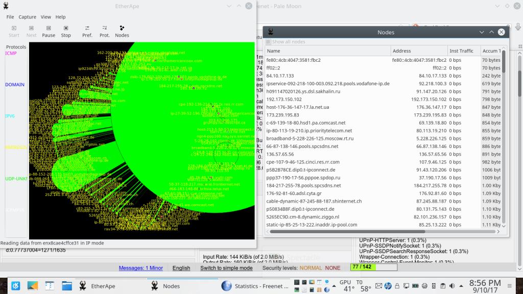

                I have my upload setting at 2 MiB and sometimes it can get intense. Here is the output of EtherApe, showing the intensity of the connections to the peers.

                The big green ball is my 127.0.0.1:8888 URL and the ring of other URLs are the peers. Some are reading or writing heavily, and some are just connected.
