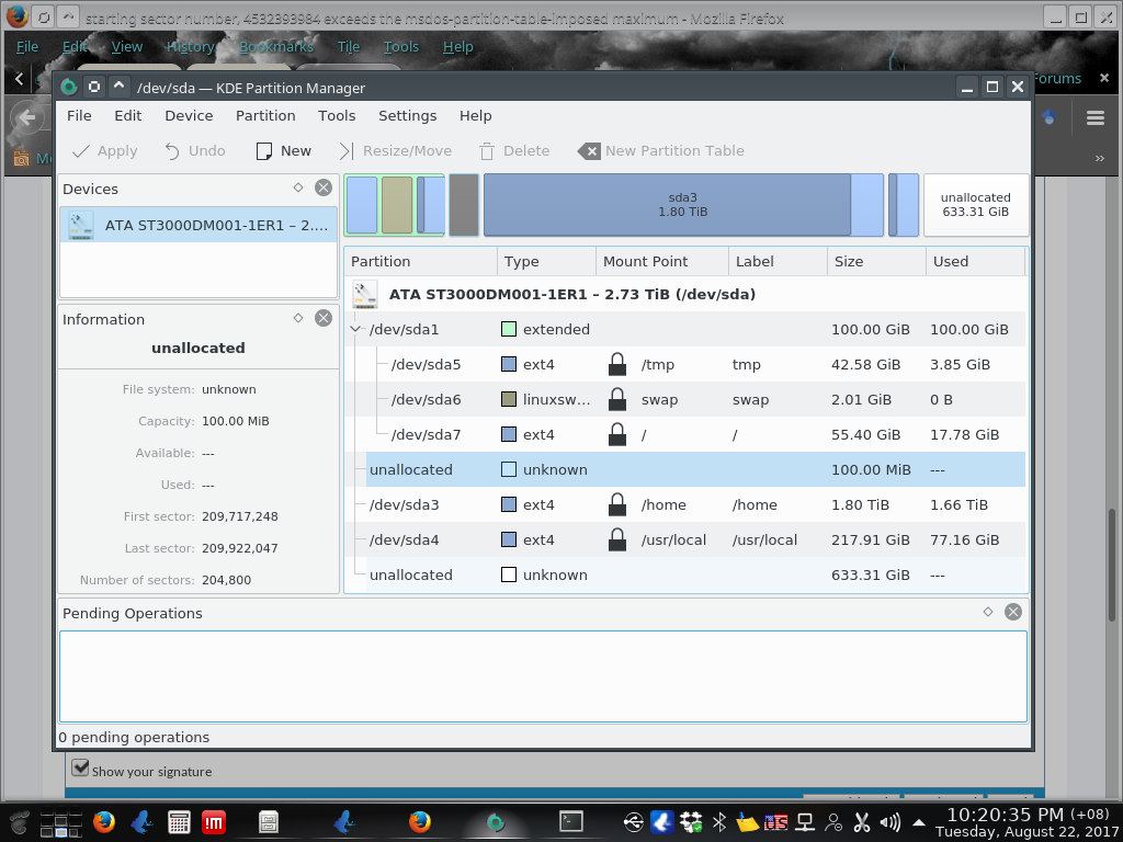

    I'm trying to add additional partitions to my 3T drive, but I'm getting this error from the KDE partition manager:
    Create a new partition (27.67 GiB, btrfs) on ‘/dev/sda’
    Job: Create new partition on device ‘/dev/sda’
    [FONT=Monospace]Failed to add partition ‘New Partition’ to device ‘/dev/sda’.[/FONT]
    [FONT=Monospace]starting sector number, 4532393984 exceeds the msdos-partition-table-imposed maximum of 4294967295[/FONT]
    Create new partition on device ‘/dev/sda’: Error
    Create a new partition (27.67 GiB, btrfs) on ‘/dev/sda’: Error
    What does this mean, and what's the workaround?

    This is because you're using MBR and it only supports 2.2TB or 2TiB. You have to switch to GPT formatting.

      1) Yes
      2) GRUB
      3)
      # sudo fdisk -l /dev/sda
      Disk /dev/sda: 2.7 TiB, 3000592982016 bytes, 5860533168 sectors
      Sector size (logical/physical): 512 bytes / 4096 bytes
      I/O size (minimum/optimal): 4096 bytes / 4096 bytes
      Disklabel type: dos
      Disk identifier: 0x0003eff1
      Device     Boot      Start        End    Sectors   Size Id Type
      /dev/sda1             2048  209717247  209715200   100G  5 Extended
      /dev/sda3        209922048 4075401215 3865479168   1.8T 83 Linux
      /dev/sda4       4075401216 4532393983  456992768 217.9G 83 Linux
      /dev/sda5             6144   89309183   89303040  42.6G 83 Linux
      /dev/sda6         89311232   93530111    4218880     2G 82 Linux swap / Solaris
      /dev/sda7  *      93532160  209717246  116185087  55.4G 83 Linux
      Partition table entries are not in disk order.
      I'm attaching a screenshot of the KDE partition manager because it gives a better view of the partition layout. (See #5 below.)
      4) I'm not yet using Kubuntu, Fedora is installed and I'm not at all happy with it.
      5) As to the partitions above, I'm planning during the impending install of Kubuntu on deleting sda5 (/tmp), sad6 (SWAP), and sda 7 (root partition), then replacing them with a new SWAP space double my memory size, and the rest of the freed space will be the root partition. I also have over 600G of space at the end of the drive where I want to add two additional partitions, /opt (~28.336G) and /var (all remaining space, ~604.6736G.) That will solve several space problems I've been having. I could also use some help getting the USB drive to boot up so I can install kbuntu, it's hanging on me during boot.
        I am not at all familiar with GPT formatting, whatever that is. Can it be switched to without touching my home and /usr/local partitions? I have no way to back up those partitions at this time.
