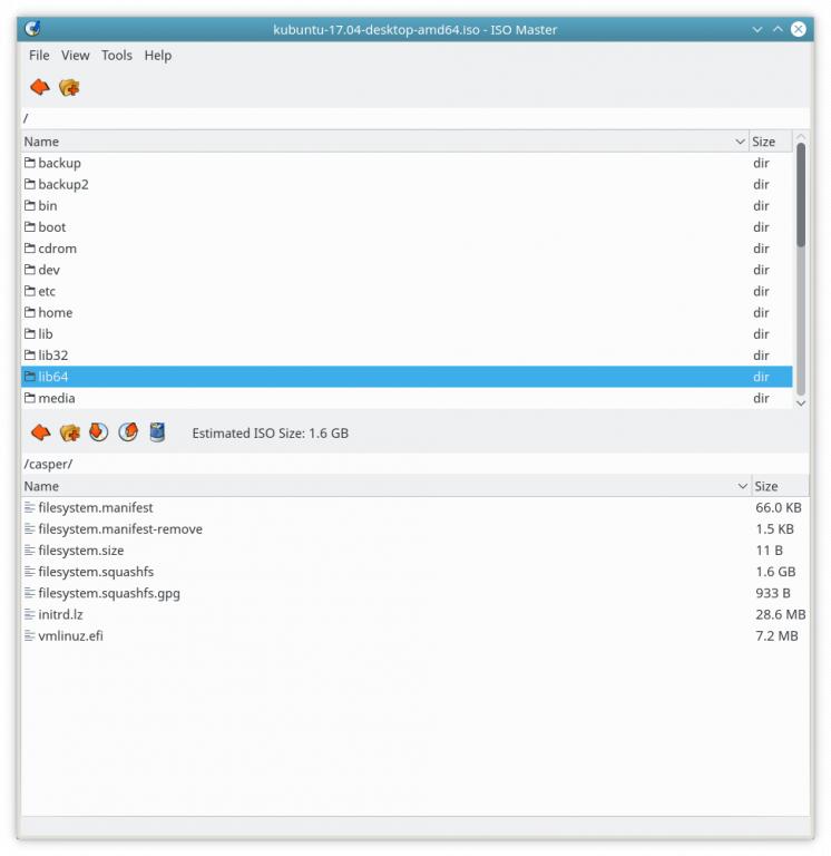

                    Hate to argue, but I have the latest D/L (yesterday) of kubuntu-17.04-desktop-amd64.iso and there's no "vmlinuz" only "vmlinuz.efi". To whit:Click image for larger version
                      humm ,,,,,now I must get the newest one and see what I see ,,,,,,,I just checked mine ,,,,,,but it's a few weeks-monthes old ...and look again.

                        well you are correct ,,,the newest one dose not have just a vmlinuz ,,,,,,,,,,,lets dd it and see what happens .
                        but befor I do that I have extracted the filesystem.squashfs from the casper DIR and mounted it ,,,,in the root of that it has the system link "vmlinuz" that points to boot/vmlinuz-4.10.0-19-generic ,,,,,,but it is not in /boot all though the system-maps and all are

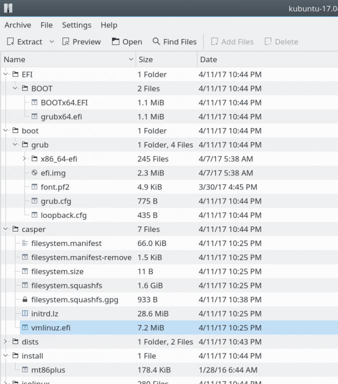

                          I concur. I just dl'd the 17.04 iso from Kubuntu's main download page and looked at it with Ark:

                          It shows what oshunluver found.
                          Dual purpose? Why isn't it working for the OP?

                            OOPS ,,,egg on face ,,,,,none of the Kubuntu ISO's I have going back to 15.10 have a "vmlinuz" in casper ,,,just the "vmlinuz.efi" ,,,,,,,but all my neon ones do ,,,,,,I must have opened one of them thinking it was the Kubuntu-17.04
