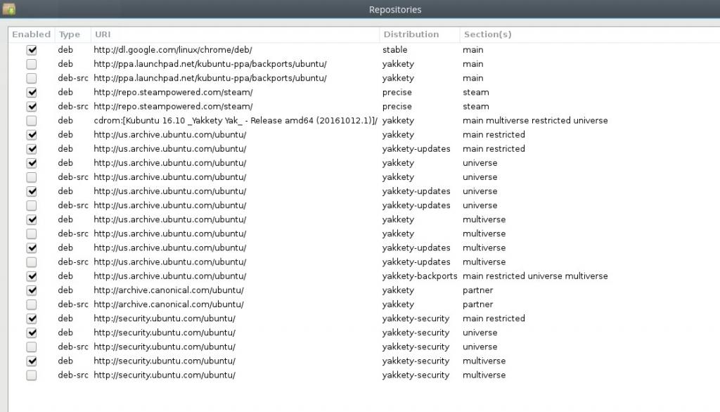

                    Here is a screenshot of my repos. It looks like the ones you mentioned are checked. Am I overlooking something?

                              Launch Muon Package Manager and check the settings I identified in post #7.
