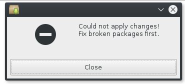

    I've been trying to install VLC so I can play a WMV file and I keep getting this message
    I've done my updates. What can be "broken"?

    First of all, I recommend using the latest version of VLC and not the one Ubuntu provide. VLC is updated very often and lots of things get fixed on a regular basis. If you choose to do that, these commands in a terminal will make the latest stable version available:
    sudo add-apt-repository ppa:videolan/stable-daily
    sudo apt-get update
    Then, so that you can see exactly is the issue, try and install VLC in the terminal so you can read the actual error messages. That error is too generic to be of any help. You either have a missing or bad dependency that VLC needs or some package installation did not complete properly. There are actually seven packages needed for VLC plus a audio backend package: vlc, vlc-data, vlc-nox, vlc-plugin-notify, vlc-plugin-samba, libvlc5, libvlccore8, and whatever audio backend works for you.
    Do this is a terminal and then post back the output:
    sudo apt-get install vlc

        What version of Kubuntu are you using? If 16.04 or 17.10 you can install this ppa and the patched versions of libgles;
        sudo add-apt-repository ppa:paulo-miguel-dias/pkppa
        sudo apt-get update
        sudo apt install libgles1-mesa libgles2-mesa
          i'm using 16.04

            If that 'apt-get update' paste is to be believed, seems you may have disabled xenial-updates and xenial-security sources.
              It seems to have worked now
