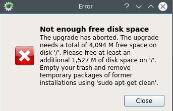

    Hi all,
    When I installed kubuntu on my computer, I set the operating system up in its own partition, and have a separate "home" partition for all my files. I am currently on Wily, but want to upgrade to 16.04.
    However, when I run the update manager and try to upgrade, I get an error message saying I do not have enough free space (I have attached a screenshot). I tried running the "clean" command suggested in the message, but it doesn't free up enough space.
    What can I safely delete? Should I uninstall some programs?

    There's no way we can tell you what to do since you haven't provided any information other than your partition is full. How big is the partition? What's on it?
    Basically, you can safely remove all the kernels except for the one you're booting. Uninstall any large programs like OpenOffice. Delete old log files as none of them will apply anyway after you upgrade. Clear out /tmp.
    Depending on what you've got on there and how big your partition was to begin with, that may do it. If not, you might be required to expand the partition or use a different one for a clean install.
    Frankly, if you've used a partition that is so small it can't handle an upgrade, you should probably consider enlarging it anyway. You could potentially end up with a full root partition which would leave you unbootable.
    You need about 8-12 GB for a full system with lots of programs. I generally recommend no less than 16GB.

        My "/" partition, which is the OS, is 21GB, about 18GB is used. I assume this is all the OS files and installed programs, but I don't know for sure. How can I tell? Is there something specific I should look for in the file tree?
        OK, how do I remove the kernels? Through Muon? Can I clear out /tmp using Dolphin, or is there a better way?

            For the kernels, look at /boot. There should be only two. If there are more than that, remove all but the latest two (assuming you're booting the latest). Likely, if you are actually running autoremove, there will only be two. You can use muon or
            sudo apt remove <KERNEL VERSON>
            replcing <KERNEL VERSION> with the version numbers of the kernel, like 4.2.0-44 etc. Doing it this way with apt in the terminal will remove all the kernel specific files for the version number(s) you enter.
            Dolphin will allow you to delete some of /tmp but there will be root owned stuff in there too. Personally, I keep /tmp in RAM so it's cleared at reboot.
            18GB sounds like a lot to me. I have about 15GB and I have a lot of stuff installed including some large games. if you run this command in a terminal you'll get an idea of where your space is being used:
            [FONT=monospace][COLOR=#000000]sudo du -h --max-depth=1 /[/COLOR][/FONT]
            I think with 18GB used, you have some unremoved garbage somewhere or a lot of leftover kernels.

              Thanks! This is the contents of my /boot folder, it's only 176MB total size so I'm not sure clearing it will give me much space:

              What is the latest version number? Can I safely delete everything that has a lower number than "4.2.0-42"?

              When I run that command, this is the output:

                You have a *lot* of software installed. I run Debian, which is a bit leaner than Kubuntu but my /usr directory is half the size of yours. Second time this morning I got to mention ncdu but that's my tool of choice for figuring out where my disk space went. Terminal program that's fast, light and easy to understand.
                Also, ncdu will let you drill down to figure out exactly where the big files are

                  jpc2769, I agree only 4 kernels isn't a lot extra. I've seen some people with 20 kernels or more because they never removed any of them. As far as "safely" remove, it's generally considered best practice is to keep the kernel you're booting and the one previous - just in case you mess up the one you're booting. As long as your current kernel is working well for you, you can remove 3.5.0- and 4.2.0-30 as long as you're booting to 4.2.0-42. There are numerous ways to determine which kernel you're using. In the terminal, type uname -r and you'll get the kernel version that's active.

                  You must have a lot of large programs like multiple graphic and video editors. I have a ton of stuff installed and I'm still less than 14GB total.
                  As far as /tmp in RAM - assuming you have enough RAM, like 8GB or more - you can move /tmp to RAM by adding this to /etc/fstab:
                  tmpfs /tmp tmpfs noatime,mode=1777,size=16G 0 0
                  I use 16GB. If you leave the size out it will default to half your physical RAM. If you "overflow" /tmpfs it will use swap. You /tmp isn't huge though so this isn't going to help.
                  Clearly, you need to either remove some programs or expand the partition or do a clean install to another partition.

                    Thanks everyone for the help! I uninstalled a bunch of old programs that I wasn't using, got rid of the old kernels, and used ncdu to figure out that some files associated with LaTex were taking up a bunch of space as well; clearing all of that stuff out freed up enough room for the upgrade.
