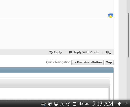

              After doing the updates I now have a bunch of launch icons on the lower right to the left of the clock.
              How do I get them off there?
              Greg
              W9WD
                Screenshot?
                  Like this
                  Greg
                  W9WD
                    Oh, you should be able to:
                    right click on the panel on a blank space
                    unlock widgets
                    go to panel options > panel settings
                    then drag the clock to the end
                      Actually, taking a second look, it appears you may have a second systray there. After unlocking widgets, try removing the one right of the clock.

                        I was able to just pick up all those icons and move them off the system tray to ...somewhere?
                        I was also able to move the speaker icon to the left of the clock.

                          Delete? Usually when you highlight (hover over) an unlocked widget, there's a little red circle with an X in it. Clicking on that deletes it.

                              Those Icons are system icons. You don't want to delete them. Oshunluver told how to move them around. if you don't want them to show you can right mouse in an empty area between one of the icons and select "System Tray Settings". In that dialog you can set each to "hide", "show" or "Auto".
