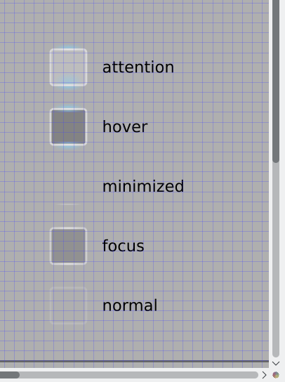

          @Here, the active or selected window is bright outlined, non-minimized are lightly outlined and minimized are not outlined. It must be in the theme.
          Here's what mine looks like, Dolphin is not minimized, Vivaldi is selected or active, and System Settings is minimized.
            You can start here if you want to fix it: https://techbase.kde.org/Development...5/ThemeDetails
              This looks like the relevant piece :
              /tasks.svg: task item backgrounds for tasks (KDE 4.1 and later). See the section on backgrounds above for information on the required elements in this file. The following element prefixes are required:
              • focus: background of focused task item
              • hover: background when the pointer hovers the task item. From KDE 4.2 focus and hover can have ticker borders that will be painted outside the task button, useful to make a glow effect.
              • attention: background when tasks item is trying to get attention
              • normal: background of normal, unfocused task item
              • minimized: background for minimized tasks
              • All the frames can be prefixed with "north-", "west-", "south-" or "east-" if the taskbar should have a different look at the 4 sides of the screen
              • The svg should contain elements of all five prefixes, if a prefix is missing that element will be not be drawn.
              • panel-north, panel-south, panel-west, panel-east : elements for the panel toolbox.
                Here's what my current Desktop theme, slim-glow has in it's tasks.svgz :Click image for larger version

                Seems like you could edit this with Inkscape and make it more dramatic or even different colors.
                  Sorry for the late reply. I forgot to monitor this thread. As for editing that file to create a bit more definition, that's definitely possible. With the latest update it's given me a bit of a different look for active vs inactive (active has kinda like the stage light effect vs not active), but there's still no distinction between not-active and minimized. But your idea does present some possibilities.
