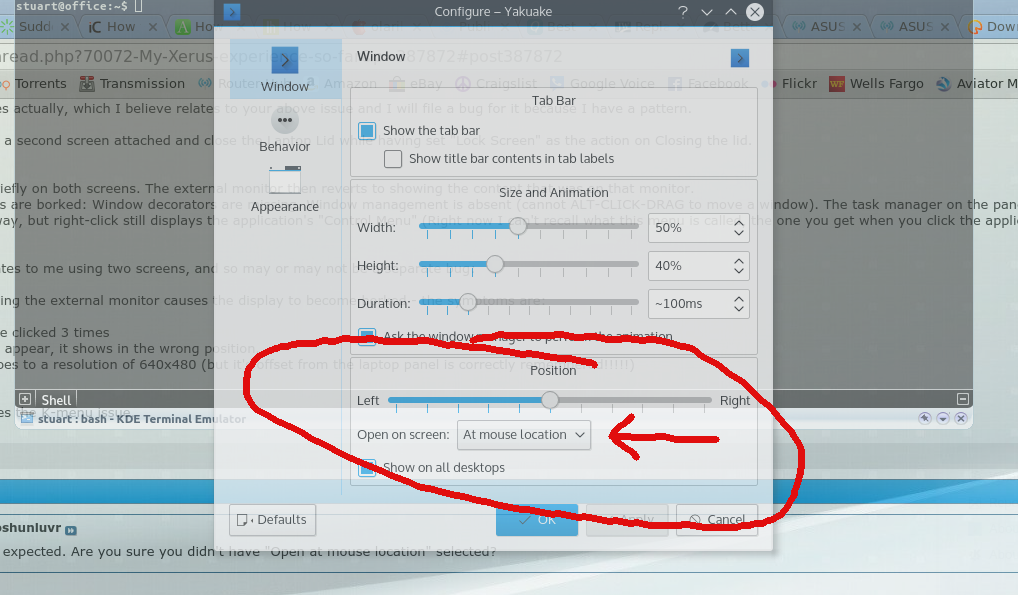

              The "Open at mouse location" option does not change the position on the screen from which Yakuake opens, just which monitor it opens on. AFAIK, there is no way to configure Yakuake to open from anywhere but the top of the screen.
              I assume you mean by "random" that it does not follow the mouse cursor when opening, like it does here (when enabled). I suggested this as a possible culprit because while it does in fact follow a pattern, it may not be obvious to someone unaware that this is the current default behavior.

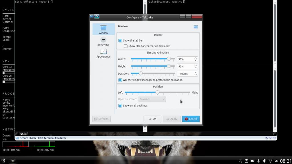

              I am somewhat baffled how you could fail to find this option, as it's on the very first page presented to you when you select "Configure Yakuake" from the menu pulldown (lower right, middle button, bottom bar, in the Yakuake window). In the lower portion of the menu "Window" tab (the default opening location for this menu), under "Position" is the "Open on screen" option. If you see "At mouse location" selected there, change it to the desired monitor.

                  So, on this machine I have only one monitor but as you can see I have three terminals. When using 14.04, the first time I use yakuake it will select the bottom right terminal and thereafter the previous terminal used. When in 16.04 it opens with the cursor in a random terminal. On a system with multiple monitors it always appears on the primary.
