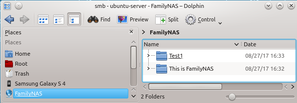

    I have an Ubuntu Server 16.04.3 configured with ssh and want to use it as a NAS. I login to to the server from my Kubuntu computer, on the same network.
    I have 3x 2TB drives configured with the btrfs. Metadata is raid1 and data is raid 5. This pool is mounted using the btrfs UUID to /media/nas. I created 3 folders on this pool: Mark, Jean, Carol, and Share. The 3 "named" directories need to be private directories -- 1 for each user by the same name. The "Share" directory needs to be shared by all 3 users.
    I installed Samba on the server, added a samba password to my account, tweaked the smb config file (below) as little as possible with a guide I found online.
    I'm still not able to see the folders I created on my Kubuntu computer. I do see "Family NAS" and that's it. When I try to open it, I'm continuously prompted for my user name and password. I think the problem is ssh. Can samba login to a server using ssh? I assume the necessary changes would have to be in the smb config file or is samba not compatible with ssh?
    mark@Ubuntu-Server:/etc/samba$ cat smb.conf

    [FamilyNAS]
    comment = Private Folder
    path = /media/nas/Mark
    writable = yes
    valid users = mark
    comment = Public Folder
    path = /media/nas/Share
    writable = yes
    valid users = mark jean carol
    No, the problem is not having ssh. That is separate from Samba. I don't know what changes to your config are needed to get samba to work, but when I had a working PC, it ran both with samba and with an ssh server with no issues.
    Often many of the 123348876389 howtos are incomplete, outdated, or just don't work, and I count the Ubuntu wiki articles in this as well. Look for one that is recent as possible, and make sure you have user accounts and samba passwords set up on the sever, and that the permissions are correct for read/write access. Been a while since I messed with this, but I am sure someone who is using it now will chime in soon enough

                Perhaps it would help if I stated the desired end result:
                - There are 3 users each with their own directory on the NAS: Mark, Jean, Carol
                - I want each of these directories accessible only by the specific user named for those directories and root of course. If user Jean tries to open directory Carol, the system will tell her she does not have authorization to open that directory.
                - There is a 4th directory called, "Share" that all users can access.
                * Is it possible for the server to identify the user by the user name and PW they entered on their client computers so they're not prompted again to access the nas?
                That's it for now.
