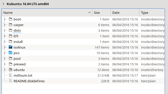

You can use the approach suggested by Snowhog to create a bootable startup disk or you can use the package usb-creator-kde. With this package you select the iso file, eg xenial-desktop-amd64.iso and it creates a bootable usb disk. An image of the usb file structure that I created for Xenial using this approach is shown in the graphic.
You can then boot this to start the installation process. When this is completed you can boot the installed system. In some cases, it may not come up correctly and you can enter the console with alt+ctl+F1 and enter username and password. The installation my then be competed by updating withCode:sudo apt update; sudo apt full-upgrade
