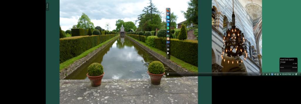

                        There have been a few updates to the NVIDIA driver and I currently have nvidia-364 installed. Unfortunately it still does not work with an external monitor on the left.
                        With the previous update I was able to capture the display with it on the left. It looks roughly like this:
                        All other times that I have used spectacle, it gives the displays as they should be, that is, not the horizontally displaced image that is present. Currently, the image displacement only happens on the external monitor, the primary display is now as it should be.
                        If I start System Settings > Display and Monitor, no displays are shown - just a blank screen.

                        After this, the only option to close down is to use the power button. Full recovery from this situation is guaranteed by deleting the file ~/.local/share/kscreen. From my perspective it seems that code related to kscreen and System Settings needs investigating for the case of an external monitor on the Left.
