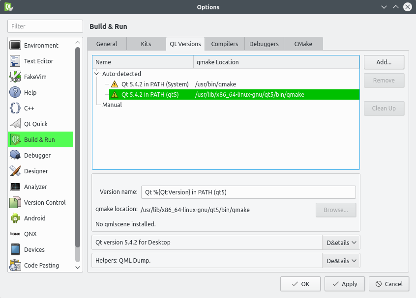

    okay, i did that. please see the result on the attachment. is it a progress? by the way, qmlscene is installed.

            well, at least the red error icon have changed to the yellow warning one and i can build projects now. let's assume the problem has been solved.

              Maybe You will understand problem better with this info:
              - about Qt Creator: Qt Creator 3.5.0 based on Qt 5.4.2 (means no newer version is needed)
              - $qmake -v
              qmake: could not exec '/usr/lib/x86_64-linux-gnu/qt4/bin/qmake': No such file or directory
              (of course there is not, I have Qt 5 not 4, file exists in qt5/bin. Manually adding path in Creator settings results in error message)
              I am not going to tweak anything nor install qt5-default package because I am not x11, wayland or qtbase5 developer and all dependencies for Qt Creator should have been satisfied in apt. I honestly see no other solution than to switch to Manjaro, everything works there.
