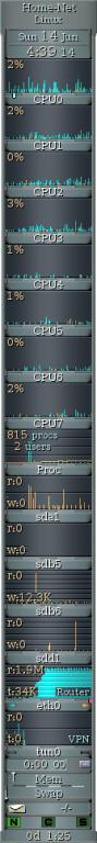

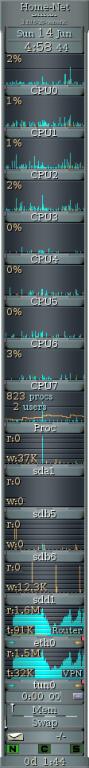

    The one I'm checking now seems to be rather spotty. I have attached 23 screenshots with the VPN disconnected and with the VPN connected. Big difference!

    As you can see from the attached screen shots the download amounts take a HUGE hit with the VPN connected VPN window is the bottom window and the router is just above it. The first two attachments are without the VPN (blank VPN window) and the last 2 are with IPVanish. I just took another screenshot of the download. The last attachment. I attached that to be fair since the d/l rate picked up considerably there.
    With IPVanish it always starts out the same as without the VPN, but then falls off fast. Now some variation I would expect since their service load is probably varying, but it is huge variation. One download I had abandon because the rate dropped to essentially zero.

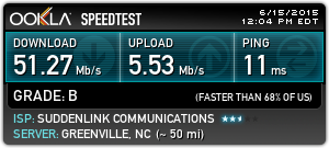

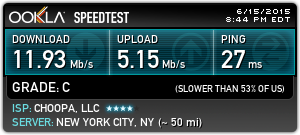

                        Here's my speedtests last night, with and without PIA enabled:
