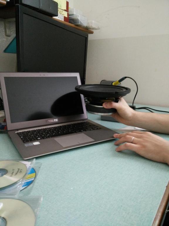

                  Hello everyone, excuse me for the delay. But finally I solve this damn issue. I tested the problem on Windows 8.1, and I noticed that happen the same thing as Kubuntu.
                  So I thought that the cause was hardware and not software (kubuntu or windows). I tried to understand what sensor would manage the closing of the lid. This sensor is located near the hinge of the screen.
                  I tried to suspend the pc by using a little magnet, moving within touching distance the laptop was suspended. In practice, the switch of the lid is was demagnetized.
                  The solution? I took a great woofer audio, I supported it for a moment above the body of the laptop and the switch is magnetized. Now everything is back to work !!!
                  Sorry if I doubted of our beloved Linux, but everything seemed to have shown after formatting Linux.
                  Despite everything, I thank you for help that you gave me. I hope it can help someone.

                      My friend, look how I solved the problem!!! lol
