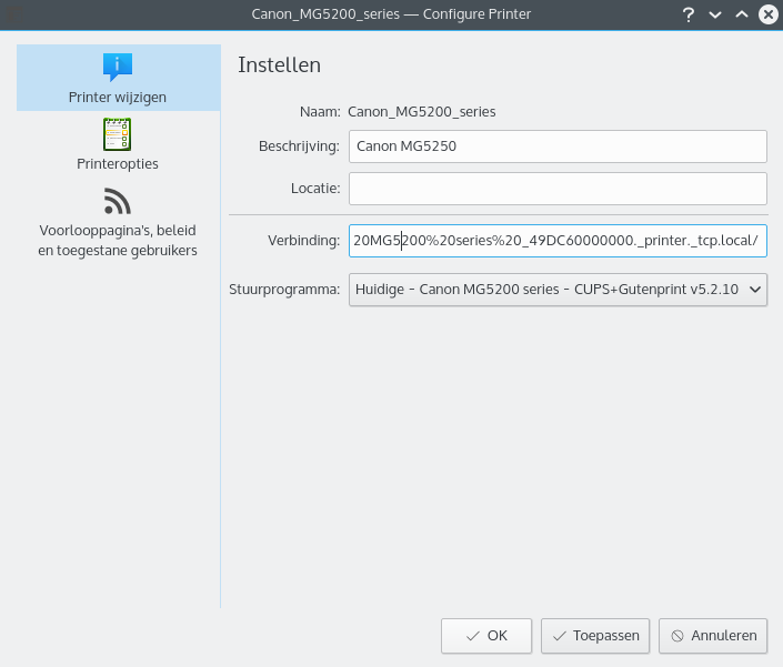

      No problem here with the Canon MG5250. using the Cups+Gutenprint 5.2.10 driver in the standard Cups database...
            It's dutch but hope you understand it. Yes i use Wifi not USB
