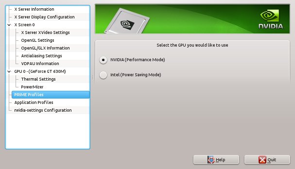

                        When I use lightDM, the NVIDIA X Server Settings look like this and I can either select the NVIDIA or the Intel cards.

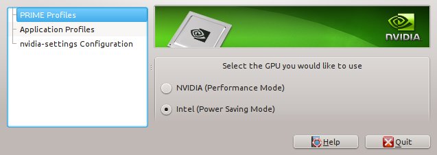

                        When I use KDM, I get a minimalist NVIDIA X Server Settings that, no matter what I do, it always stays with the Intel card even after selecting the NVIDIA card. The KDM, NVIDIA Settings look like this:
                        As you can see it is totally different to what I get with lightDM. I just hope that SDDM solves this problem as I am sure the Ubuntu users do not have the problems that I am having with the NVIDIA card.
