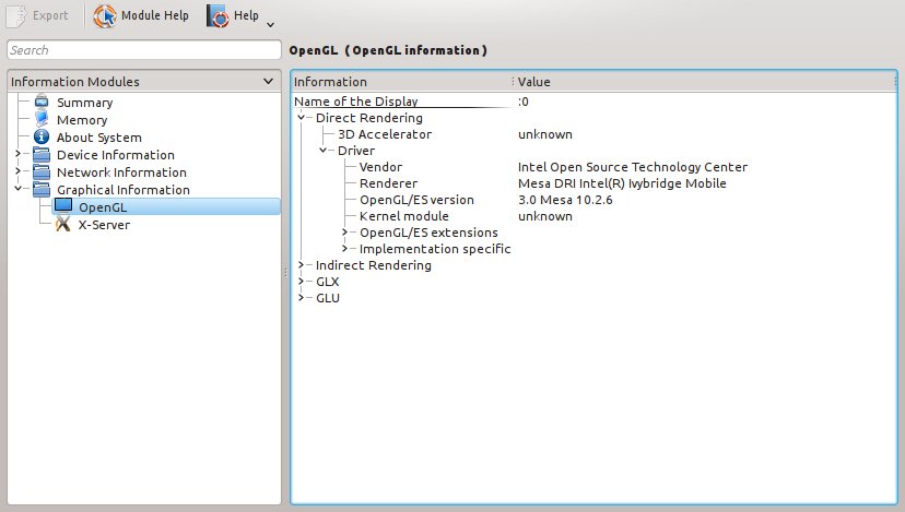

From this, I would suspect that my Nvidia driver is operating. However, when I look at Kinfocentre, OpenGL, I get the following:
Which tells a different Story. Do I have the Nvidia driver working or not? I have two graphic cards and I am wondering how to switch between the Intel and the Nvidia cards without resorting to Bumblebee.
