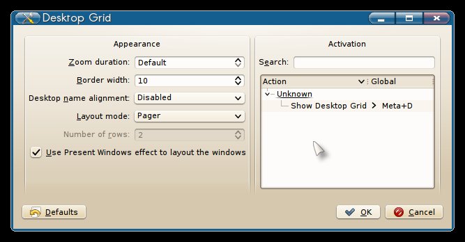

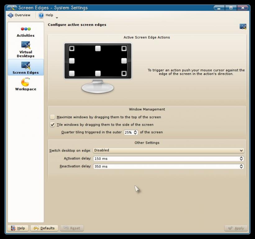

    I'm also using K14.04, KDE 4.13.3. In my experience the desktop edges/corners isn't 100% reliable here ... sometimes it just doesn't work the first time and I have to try multiple times before it reacts to the mouse. I have Desktop Grid set to a shortcut key (Meta+D). I temporarily set it to the centre top screen edge as you have and it did work here. Maybe you have inadvertently changed a setting that is stopping it from working (perhaps a clash with another desktop effect ... I've had that happen in the past)? I'm attaching a screenshot of my settings below as a comparison to your own.
Name:	Kubuntu 14-04 (Trusty) Configure active screen edges.jpg
Name:	Kubuntu 14-04 (Trusty) Desktop Grid settings.jpeg
