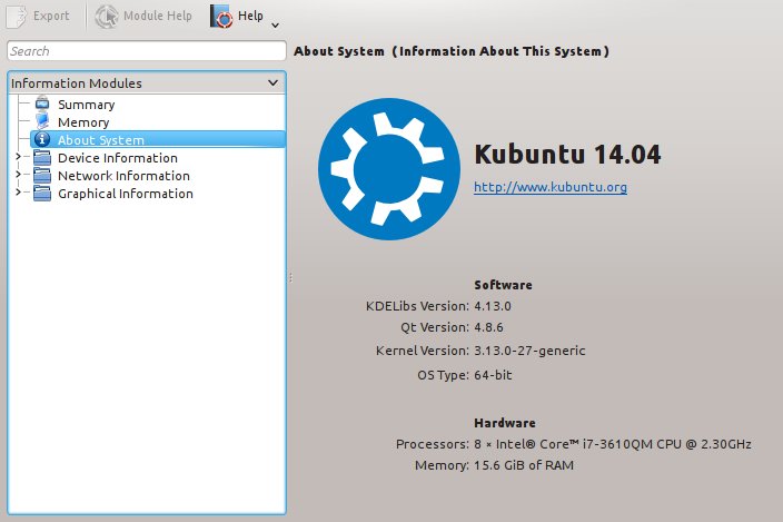

                      Looks like it could be KDE 4.13.1 as I have 4.13.0 as shown in the attached graphic. So I think it would be appropriate for you to submit a 4.13.1 bug report as I would not be very pleased if this feature existed when it is released.
