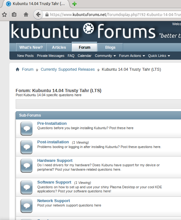

    I just installed 14.04. Everything seems to be working nicely, except the fonts look awful. Everything looks blurred or fuzzy. See screenshot attached. I've looked around the internet and tried every piece of advice I can find: changing the fonts, enabling anti-aliasing, forcing the DPI, using Infinality. Nothing has made it any better. It seems trivial, but actually it's not -- it makes everything so unpleasant to use/look at/read for prolonged periods that I might have to give up on the OS if I can't find a solution.
    I'm assuming it's the fonts, since they look so bad -- but perhaps the whole display is blurred. For what it's worth, my graphics card is a Radeon Mobility Express 200.
    So -- does anyone have any ideas, besides those I've already tried, for sharpening up the appearance of the fonts?

          Good point; sorry. This is an LCD laptop display (is there more info I could give about type? I'm not quite sure what you're referring to).
          I've noticed, by the way, that I have no options to change screen resolution, either under system settings or via xrandr. Perhaps that's unconnected.
