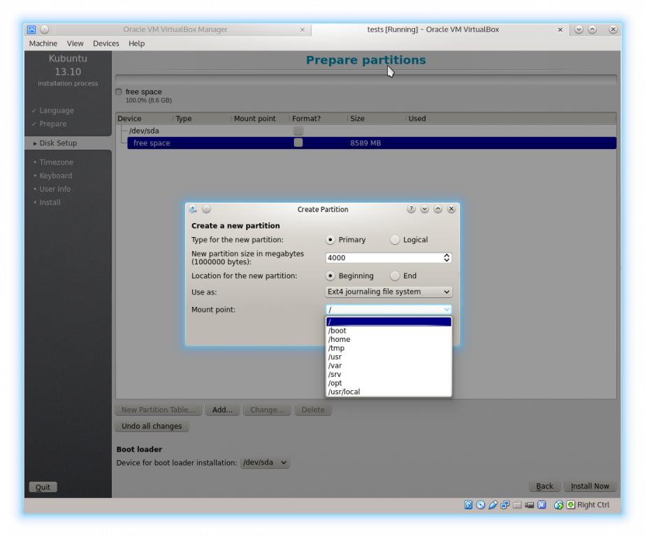

    That error usually means you didn't specify the root location. You selected the correct partition, but then must "edit" it and assign "/" as "Mount point:" pictured here
    When you manually partition using Ubiquity (the installer we're using) you must indicate what goes where along with formatting options, etc.

        The screen shot I posted clearly shows where to click to set the mount point. Simply select "/" there and it should install.

            When you choose manual installation it's up to you to decide where to put things and whether to format any given partition. Everything you're expecting to see, you WILL see as soon as you highlight the partition you want, select 'Change', and then proceed from there. As oshunluvr's image shows, you'll have the opportunity to assign a root partition, and whether to format it.
              The screen shot you posted says, "Create a Partition." I do not want to "create a partition." I want to preserve the partitioning that now exists on each of my 2 hard drives. Nor do I want to boot an operating system. I want (the installer) to do 2 things: (1) reformat sda3 and (2) install Kubuntu 14.04 on that reformatted partition. From my point of view, for the installer at this point to want me to name "the root system" is illogical. At this point, all the installer needs to know is where (which of sda's existing 3 partitions) I want to install Kubuntu. I conveyed that info by selecting (highlighting) the sda3 partition. Then the installer should alert me to the fact that in order to install Kubuntu on sda3, that partition must be reformatted, and it should ask me if I want to proceed. I will answer Yes. Then it should reformat sda3 and install Kubuntu. Then it should tell me to reboot my computer. When I do, the boot loader should present me with a menu asking me if I want to boot into Mepis 11 (which sda1 contains) or Kubuntu 14.04 (which sda3 contains). That choice will determine (define) the root system.

                On my screen shot it says "Create" because I used free space on a virtual drive. On your's you will get that exact same screen, except it won't say create. You will select your partition, click the "Change" button. Select the format type in the "Use as:" box . Tic "Format the partition:" Select "/" in "Mount Point". and click OK, then click install.
                One word of warning: Ubiquity assumes you want to install Kubuntu's version of GRUB in your hard drive MBR. If you are planning to play with Kubuntu for awhile, but not convinced you are going to keep it, you may not want to do this because deleting Kubuntu will delete GRUB leaving your system unbootable. You should see an option at the bottom of the "Prepare Partitions" to select the GRUB install location. Unfortunately, some developer decided long ago that we no longer needed a "Don't Install GRUB" option, but you can select the install partition (sda3?) and it won't effect your MBR. Obviously, if you do this, you'll have to boot to Mepis and change GRUB there to dual boot. Another option to avoid the GRUB install is to launch Ubiquity from the command line using the -b or --no-bootloader switches. If you decide to keep Kubuntu as your primary OS, you can re-install GRUB later with little effort.
