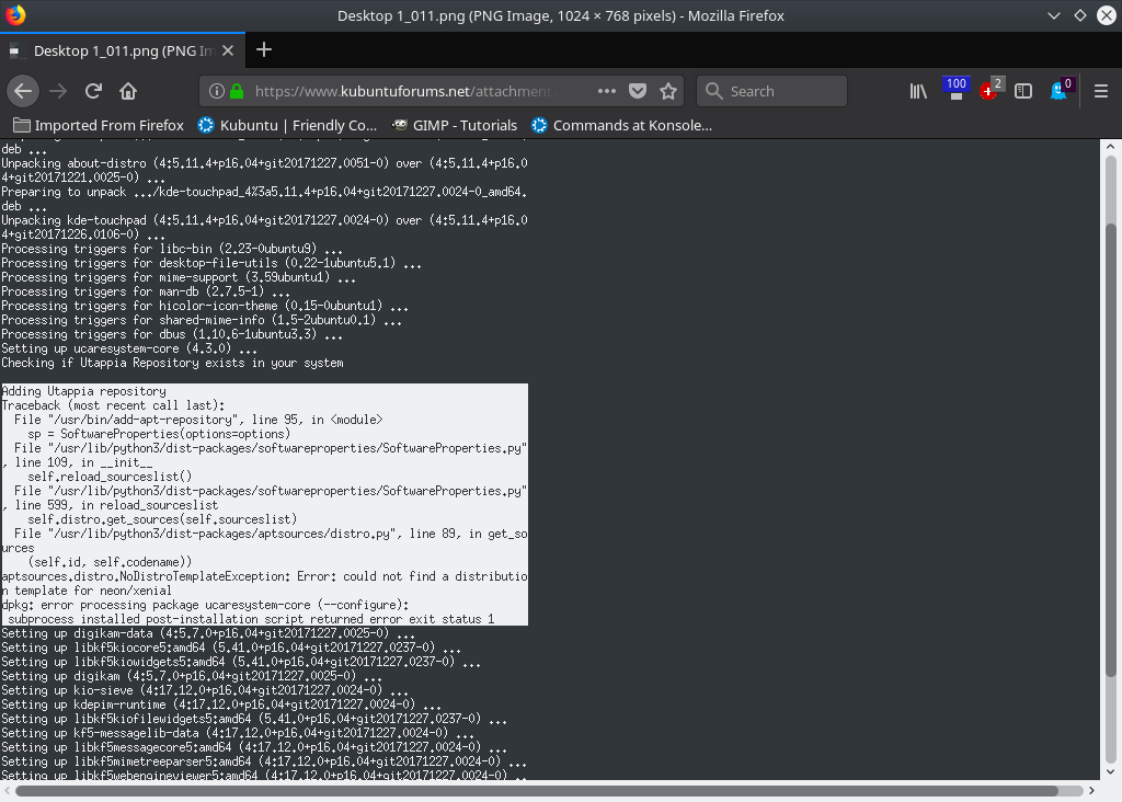

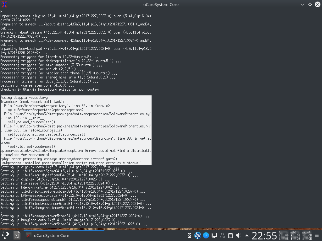

            Actually, Vinny, I for one appreciate your scepticism. I like the program, but every time I run it get a series of error messages while it seems to complete every task assigned to it. I'm including a screenshot with a highlighted section which appears during every task. I don't know why I keep getting it and I don't know what is wrong. As long as I keep getting this I do not depend on ucare for my daily maintenance tasks. Can anyone tell me what's going on?
              #21
              The image you posted is to small to be able to read the text when zoomed in on. Can you repost with a full-sized image, or just copy/paste the relevant text?

                #22
                Hmm, I thought it was a full-sized image. Here's another version, and it seemed to zoom all right in Firefox.
                  #23
                  You have a 3rd Party Repository -- Utappia -- which doesn't appear to be available for neon/xenial. That in itself raises the question: why are you using a neon/xenial PPA in a Trusty installation? Mixing repository versions is generally not a good idea.

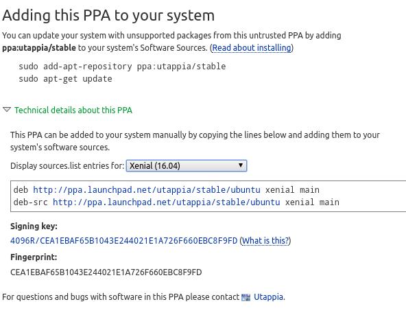

                      I just check and Utappia does have xenial packages. I wonder if you have a mis-configured source in apt for that PPA.

                        #26
                        Ah. So the PPA is where ucaresystem-core is obtained. But he's using neon/xenial instead of trusty. He should just need to change the designation in the utappia sources list file to trusty. Then update the package cache and re-run the script.
                        Slava Ukraini! 🇺🇦
                          #27
                          I'm not the one using Trusty. I have a Neon/Kubuntu hybrid (16.04) and was taking advantage of the thread to ask why I got the error messages. I just followed the link to download and install it. Maybe it's the hybrid nature of my OS. I have no error messages with Lubuntu (on my old netbook).
