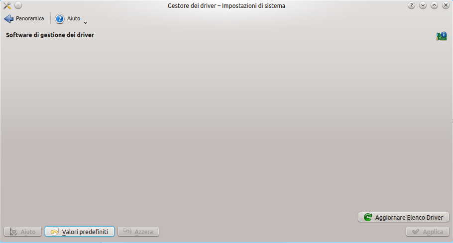

            I think that there are some issues with my wifi card (Qualcomm Atheros AW-NE785 / AW-NE785H 802.11bgn Wireless) and my kernel, so I tried to find if there is a proprietary driver for my hardware, but the "new driver manager" seems useless...

              Driver issue IMO, just like you suspect. Jokey (driver manager) won't show a proprietary drivers for atheros, as it works with open source. Still, the company could have made available for download, on their site, a new version, not yet included in a kernel. You should visit their site, download and install the driver from that source, even if the same you use now (could have been corrupted, and reinstalling it solves the issue). Or wait for a new kernel, hopefully including a new driver. Meanwhile, I believe you can reactivate the wifi by shutting it of and than on from the dedicated F button (on my acer it is F3). No need to reboot.
