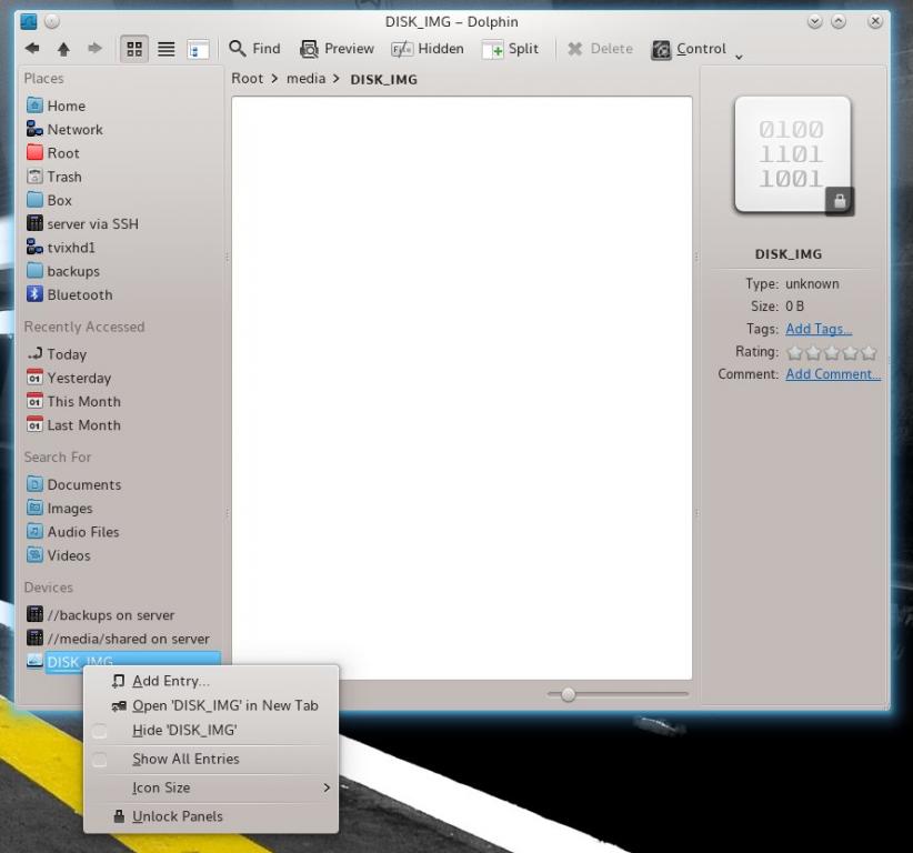

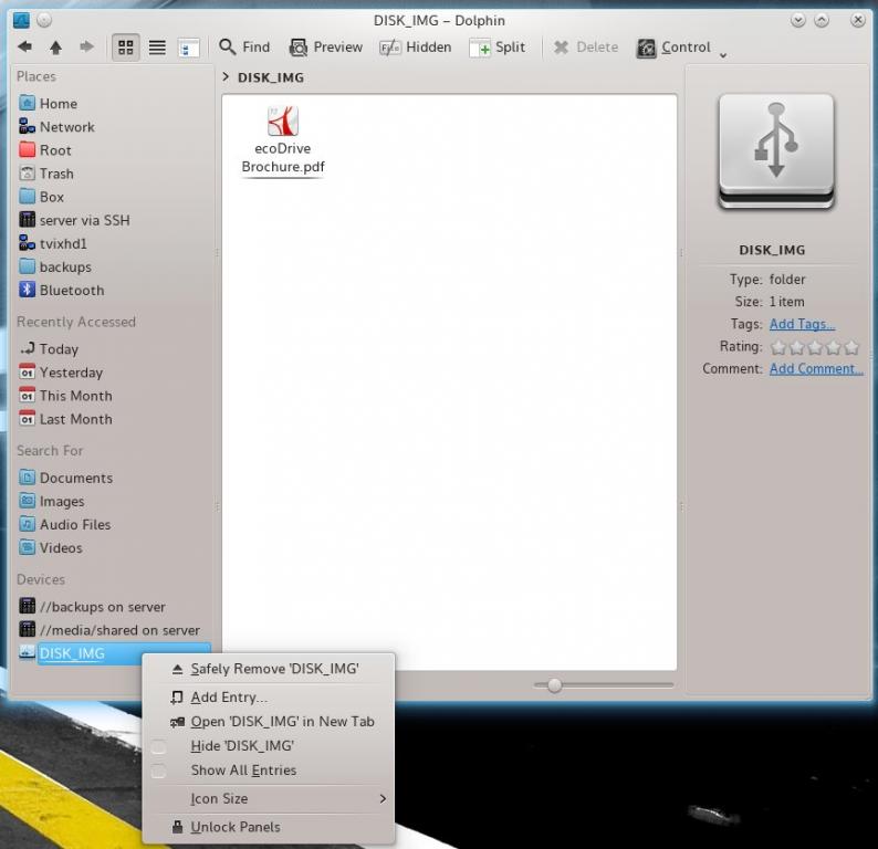

                          My screen shots in order:
                          #1 USB drive inserted but not yet accessed
                          #2 Submenu showing available options while unmounted
                          #3 Submenu after mounting showing only additional option "Safely Remove"
                          #4 After "Safely Remove" USB drive missing
                          The only way to get it back is to pull and re-insert.
