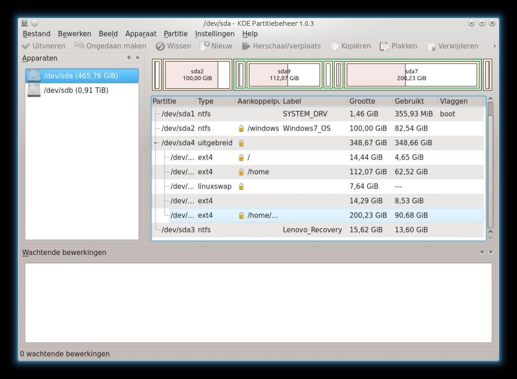

                The KDE partition manager on the Live disk does have a GUI, it looks like Gparted.
Name:	KDE parted.jpg
                  [ATTACH=CONFIG]4345[/ATTACH]
                  LOL ,,,,yup I forgot all about that ..........when you sead "parted" I was thinking the CLI parted .
