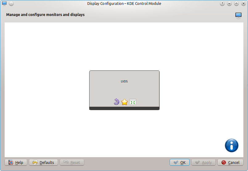

                    That worked perfectly! I still get sound through the speakers too.
                    You, sir, are a genius.
                    Not only did you solve the initial problem, you actually solved an even bigger problem I had been having before (the overheating). The only solution I had found in the past was to use the proprietary driver, which I was reluctant to do. Now my laptop's temperature is down by a massive 25 degrees C!
                    I did get a small shock initially when I logged in, because the panel from the LVDS-1 screen had moved over on top of the current one. Once I had deleted that, everything was back to normal.
                    Thank you so much!
