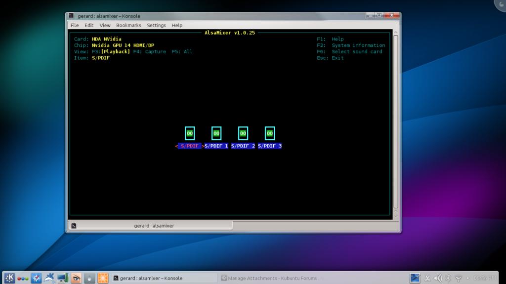

        In a terminal, type "alsamixer" Check the levels of all your sound devices. Use F6 to change sound devices and if anything says "MM" use the M key to unmute it.
          I got the mixer up in a terminal and selected the HDMI card. But there was nothing there to adjust.
          Then i installed Pulseaudio volume control and was able to boost the HDMI output to about 156%.
          That gives me a reasonable sound level so i am happy with that.
          I have enclosed a screenshot so you can see what i mean with the Alsamixer.
          sigpic
            Mine looks the same. Sometimes they end up muted and sometimes volume levels on the main card get messed around.
