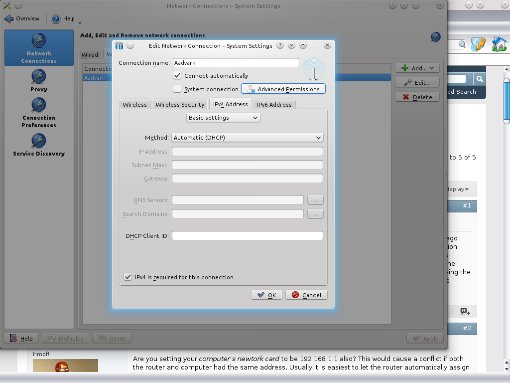

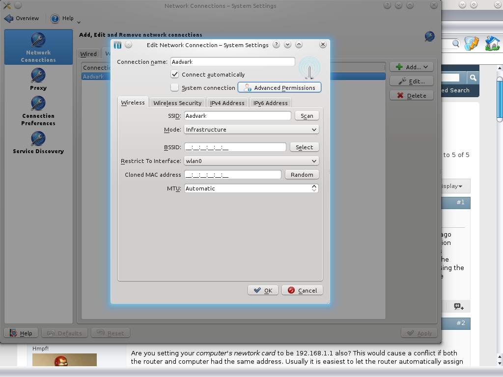

            Here are two snapshots of my how my network is setup. It's almost a waste of pixels! The first is a picture of the wireless tab, where I identify my SSID and gave the connection a name - rest is just defaults. As you can see, there is a Scan button that will show any broadcast SSIDs in your area, including your own if your router broadcasts its SSID (which you can do temporarily, if doing so bothers you). The second is the IPV4 tab with Basic Settings shown of Automatic (DHCP). The last step is go to the Wireless Security tab and select the mode (i.e., WPA2, in my case), along with the password to access your router. And that's pretty much it, as long as you spell everything correctly.

              It wasn't a waste of pixels because it made me realize where I made a mistake. I didn't tell you that I'm connecting to my router using a cable (sorry ). I use the wireless network to connect with my other devices. The cable connection between my PC and my router is what's not working (neither manual or automatic).
