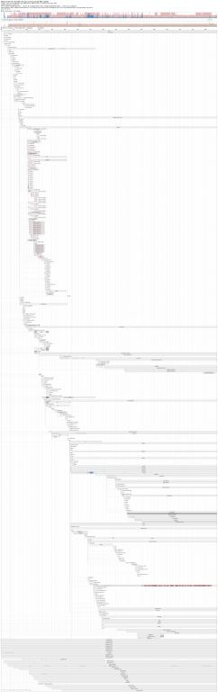

                        Without more details, it's very difficult to diagnose a problem like this. Have you installed and examined a boot chart?
                          Ok, I installed bootchart and here is the file it generated.....

                            You're going to have to post higher resolution pic. There's no way to read that. Try uploading to http://www.pictureshack.us/
                              Ok. I did the pictureshack and it gave many links. I copied this one....
                              http://www.pictureshack.us/view_8600...20140124-5.png
