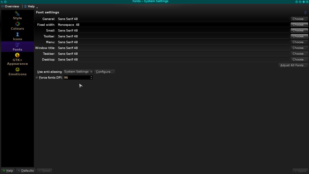

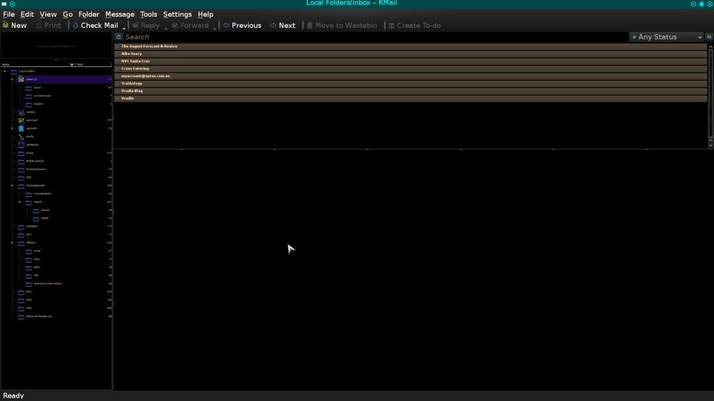

    After recently moving from VGA to HDMI on a full HD-1080p TV I had noticed that Fonts were no longer legible (all too small) My workaround by changing the font settings in System Settings> Application Appearance> Font and changed the font size to one that was acceptable (around 26/28pt for 1280x720p & 48pt for 1920x1080p . That worked for most applications and the desktop but...

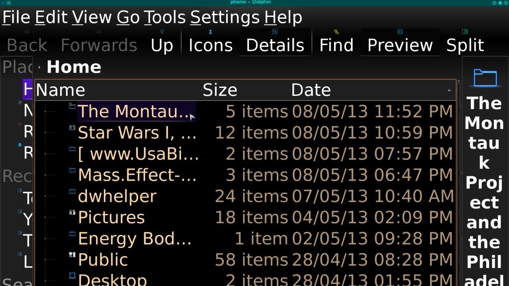

    ...Then dolphin had font issues that were rectified with dolphins in built font settings (pheww).

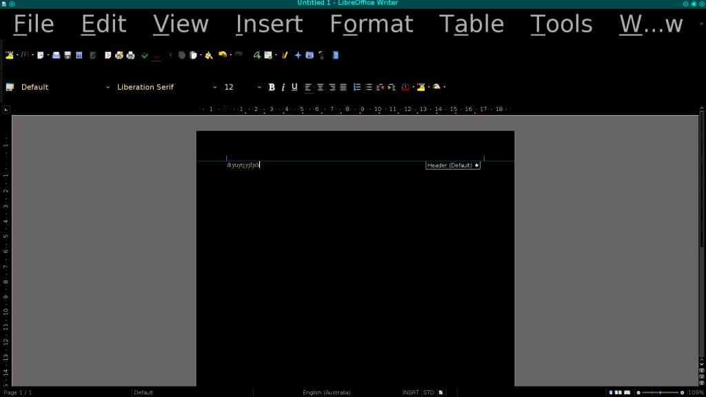

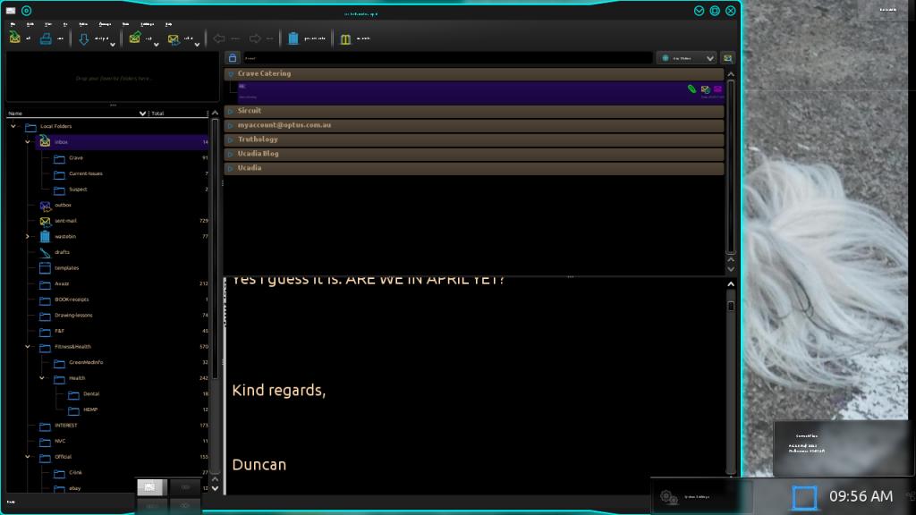

    Alas though Libre office still has issues with the General Font size (especially the menue bar font being super large) as does Kmail fonts being too small again but unlike dolphin lacks adjustable font settings that fix my issue...
    ...Has anyone else also experienced similar?

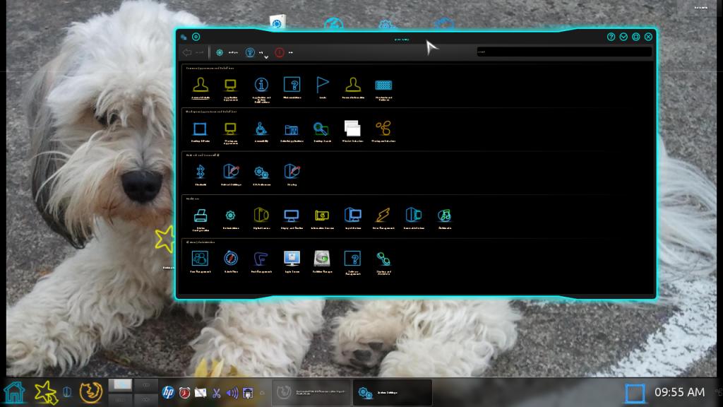

            Here are some screen snaps of fonts forced @96DPI ss0 to ss3...
            ...and ssa0 is the 3 mentioned programms without DPI forcing. (keep in mind dolphin has its own in-built font setting(yay))

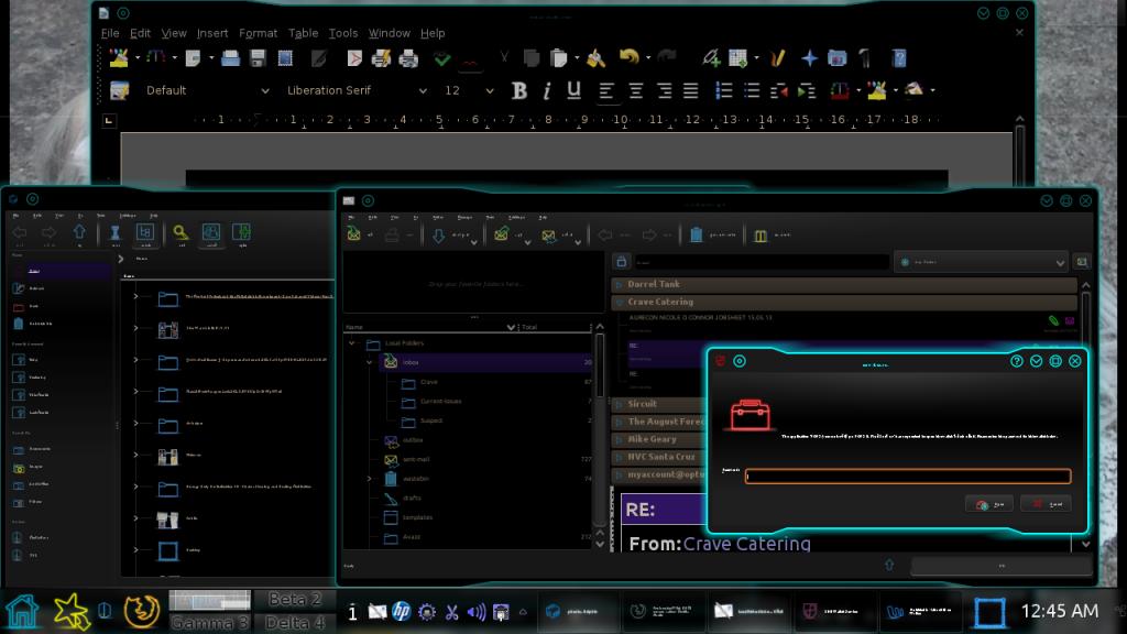

                    Ok did xrandr command, @75 had little effect so I reset the default fonts and it all reverted to very small (exept libre office reverted to perfect font scale-go figure) this is what it looked like ....
                    ...Click image for larger version
                    See how it all goes very small even dolphin with internal font control, as well unreadable wallet pop up.....

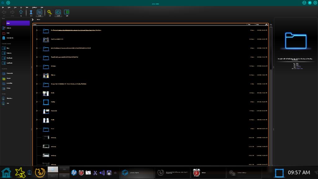

                            The real result in screen snap (res-1280x720p)
                            Also after all that the xdpyinfo |grep res reverted to 32x29.
