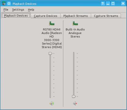

                      So, you just had to un-mute the "Built-in Audio Analogue Stereo" channel in KMix?
                        when i looked at the KMix window, i was under the impression that the buttons that were below the sliders were actually icons - that they did NOT change state unless some other setting, somewhere else, was changed...
                        the way ICONS like that are, in EVERY OTHER OPERATING SYSTEM...
                        i spent two weeks (the last of which was spent here, moodging around with various different audio settings) having no sound on my box BECAUSE of the fact that the "icons" were "buttons" (i.e. they have two states), and nobody thought to mention that to me.
                        the fact that the "mute/active" button/icons below each audio device DON'T LOOK LIKE BUTTONS was the main problem. once i worked out the fact that they were actual buttons, and not icons, i no longer had a problem. all they would have had to do was put a rounded-corner border around the icons, so that they LOOKED LIKE BUTTONS, and i wouldn't have had any problems to begin with.

                          Agreed, that really doesn't look like a button when your mouse cursor isn't hovering over it... and of course, unless you suspect it might be a button, there's no reason to put your mouse cursor on it. As you say, making it look more button-like would be a definite improvement, or maybe a check box with the word 'Mute' beside it.
                          KDE definitely has some areas where the discoverability of its features could be improved. For example, I had decided not to use certain plasmoids because they insisted on being square shaped, and I wanted them to be rectangular in order to fit nicely among the other plasmoids on my desktop. Then another member here tipped me off to holding down CTRL while resizing the plasmoid; that particular feature has essentially zero discoverability.

                                I guess I was lucky. One of the buttons was a different color.
