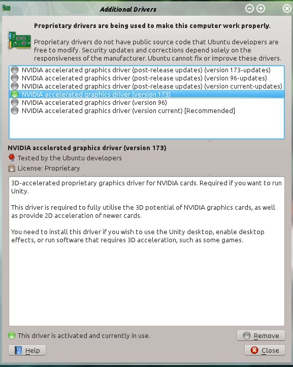

        So I just happened to look under System Settings and saw Nvidia Server Settings are there. This seemed odd. And I did the check for Additional Drivers and see that the version173 driver is activated! I swear I didn't manually do that, but maybe I'm losing my mind!
        But my question is: There is also (post release updates) (version 173 updates) listed, as well as the (version current) Recommended driver, which is what I always have used before. PLUS the (post release updates - version current) driver.
        I'm wondering if I activate the Recommended driver, will that improve my effects performance? I've got a good thing going here, besides the choppy transitions, and I'm a little wary of screwing it up now. And then I just read about the "x-swat" repository that may provide an even more up-to-date driver, so I'm not sure what the best course of action is.
        Can you possibly enlighten me?

            Hi Uthur.
            173 is the "best one" now for cards up through about 8600. I may be wrong on that, but when I put my 8600 card into the gaming machine, that was what I installed.
            The "default/recommended" was doing just fine except for a game, in other words, for "workaday" stuff, the Linux driver for a 6600 was doing a bang-up job.
            And Aardvark's suggestion about at least a gig is a good one. I run 2gig.

                  Re: No proprietary driver found? I've been using it in Linux Mint 10.
                  Post-install updates means the driver will get updated as nvidia releases new drivers and they're packaged for Ubuntu, whereas the typical method means you'll use the driver from the Oneiric repos. The post-updates are a new and not completely tested out function, so I'd stick with the recommended method.
                    OK. I'm thinking maybe I should try the 'Recommended' driver and see if that makes a difference. Also, I just realized something... could the slight choppiness or hesitation in some transition effects be the result of using Kwin instead of compiz?
                      According to nVidia the current drivers (290. is latest from nvidia, 270. was the last in the repo I noticed) are correct for your card. You should install the version current driver.
                      The next steps are to verify your BIOS has maximum memory allotted for video as most 6150 cards used shared memory and then properly configure your card in xorg.conf to take full advantage of whatever features your card offers.
                            Update: I installed Recommended driver and things seem the same. I'm curious about something: I have an AOC 22" monitor, and when I boot up the message "Input Not Support" floats around the screen for a moment before startup. In the past with other 'buntus when I've installed the Recommended driver, this does NOT appear.
                            One more thing: I looked around in the BIOS again and found:
                            Under Primary Graphics Adapter - 'PCI-E' is selected. There is also a choice for 'Internal'. Should I try that?
                            And I also found 'VGA Shared Memory is Enabled. The maximum choice is '256', which is enabled.
