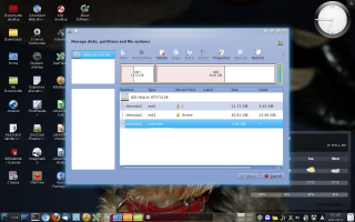

    Just done a re-install and forgot to check the "format" box for the swap partition during the process.
    Running the partition manager reveals an "unknown" partition of 1.95 gb. It remains that way after using a live version to format the partition as linuxswap.
    I believe the problem to be my fstab. I have played around with it to try and sort this but, currently to no avail. The contents are:

      I have commented out the final line but no joy. After a reboot and a further formatting of the partition the partition manager looks like this
      Sorry it's not very clear but I had to really downsize it to fit the file size requirements. In case you can't see it it shows sda3 with type "unknown"

        that is strange ........perhaps a deletion and recreating the partition is in order ......IS your /home encrypted?
        that pick was almost to small to see in gwenview ......after enlarging it pixalated quick .
