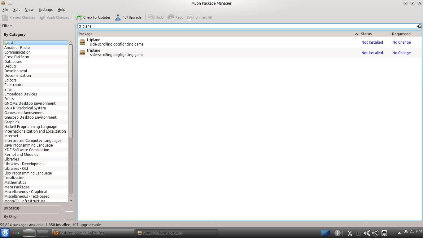

                      Just had nasty experience with muon, i am not sure if its muon fault or should happen but automatic preview changes wouldbe nice - i installed triplane that depended on libsdl-alsa, although it only swaps libsdl-pulse with libsdl-alsa all many libsdl using packages were uninstalled :S

                        Unless triplane is a package in the standard repositories for 11.10 (it isn't in 11.04), it is a non-standard/third-party repository application, or a .deb file downloaded from the 'Net and installed 'manually'. Either way, it is an 'unknown' and can (and apparently did) introduces dependency issues. I still say that it isn't Muon that is the root cause.

                          Just tested - Triplane is 11.10 universe package and when installing triplane through synaptic while having libsdl1.2-debian-pulse doesnt cause this behavior. So its either muon or i truly somehow accidentally removed package while browsing software with muon? Ill test it soon in another computer.

                            Ok tryed again and found something odd: muon shows package twice and upper one installs fine, below one wants to break system. It seems all packages are doubled... Strange... I think below one is "treat reccomended packages as dependencies" feature turned on... Very strange... Heres screenshot:

                              This is due to the new multiarch support, and should be fixed soon. See this bug
