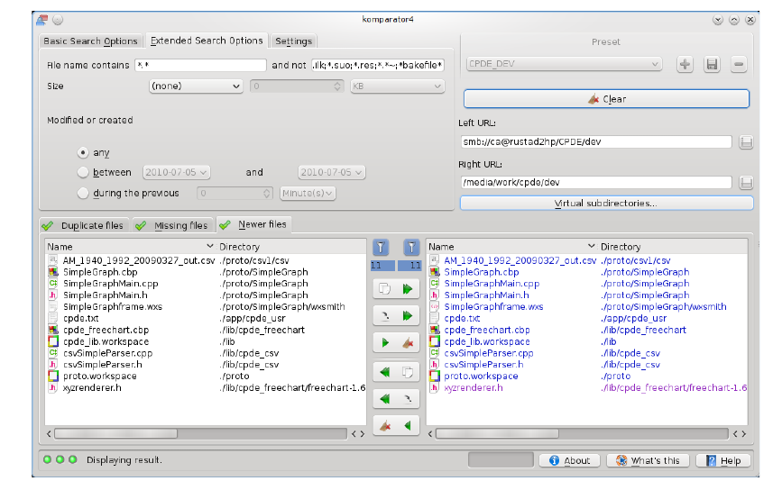

              Originally posted by cdupree
              I've downloaded Komparator4 but haven't yet had time to spend learning it; is it worthwhile? Or does someone have another way they like better?
              To use komparator4, you must define named Presets which are essentially left and right root
              directories defining what to be synchronized. Also, under the Extended Search Options tab one should define which files to search for (*.* is recommended) and which not to search for (typically a semicolon-separated list like: *.suo;*.ilk;*.res; ...)
