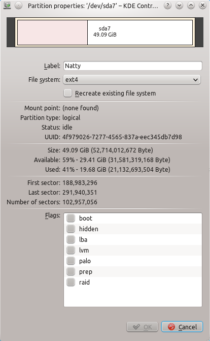

          Re: Labeling Partition
          In the default (KDE) Partition Manager application you should be able to change the label of a partition through the Properties dialog.
          Kubuntu 20.04(AMD64)/KDE 5
                OMG!, yes it's there. At the first line!
                How could I missed that...
                Thanks for telling me.
