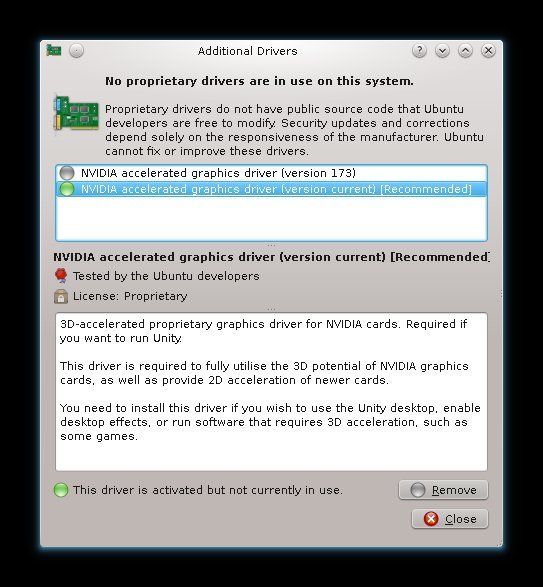

                    Well this is interesting (see attached). What does it mean "This driver is activated but not currently in use." I guess obviously it's not being used!?
                    So how do I check what driver I'm actually using?

                          Re: Long delay until I get the KDE login screen
                          Well, it looks like jockey-kde is telling lies.
