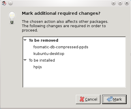

I could not find foomatic-db-hpijs so I removed hpijs. After doing this I got the dependants shown in the graphic. This looked quite safe, but when I went to install foomatic-db I got a message that the kubuntu-desktop would be removed  . I decided to not proceed but should I have continued and would I still have my desktop?

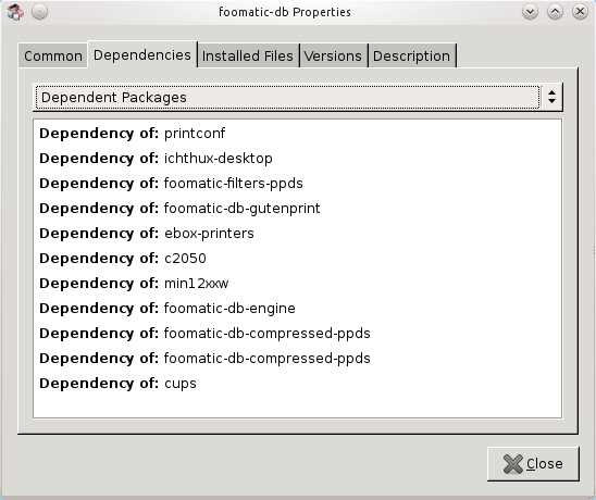

				So I think there's a problem between foomatic-db and foomatic-db-hpijs. But it says the foomatic-db package is the replacement, so maybe you can remove foomatic-db-hpijs and then install foomatic-db and get a different result.
