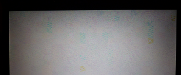

      now beginning to get a white screen

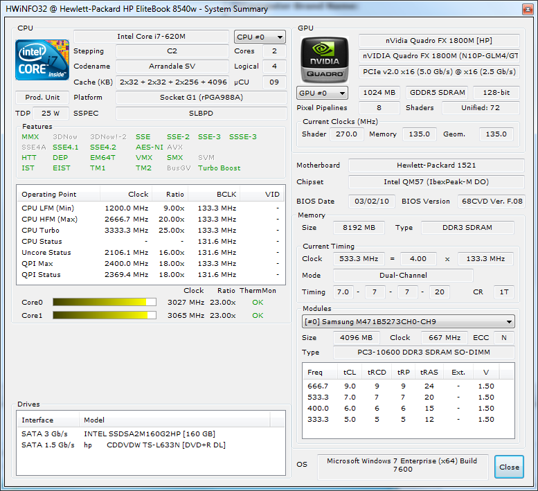

      HW specification see Attachment

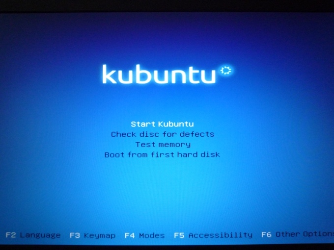

            Picture2 its a first screen show at boot

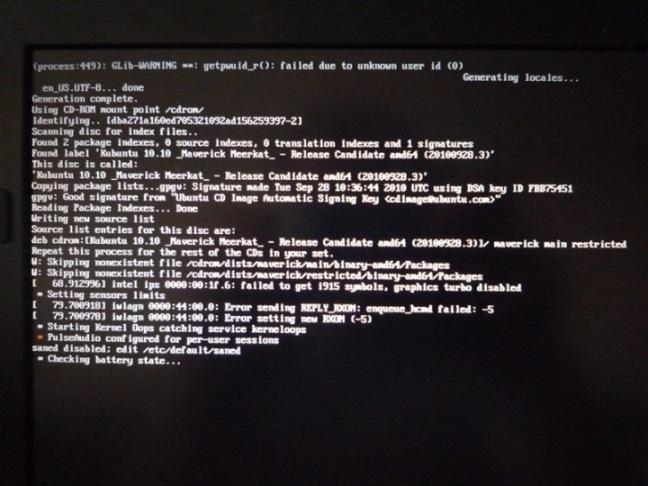

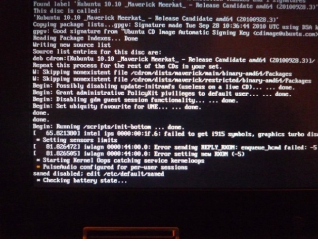

            Picture1 its a output before i get a white screen

              ?ware is picture 1?
                Re: 10.10 RC on nb hp 8540w
                upload picture1
                  Halting on the battery check. Hmm. ACPI issue?
                  See BootOptions - Kernel Options on Ubuntu Community Documentation.

                    after last line come a white screen

                      Ah, an nVidia GPU. On the initial screen when the LiveCD has booted, F4 Modes, allows you to choose which video mode to use while booting. You want to select the Safe Graphics Mode (or it's equivalent). This 'should' allow you to proceed to a usable desktop environment. It won't be pretty, but will be functional. From there, setting up your nVidia GPU is doable.

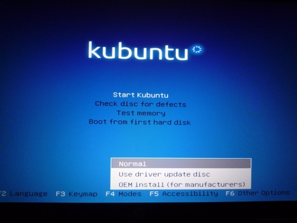

                          Okay. What options are presented with F6?
                          Found this:
                          Enter Safe Graphics Mode In Ubuntu Or Kubuntu 10.04 Lucid Lynx Live CD
                          Read down to BUT WAIT! I DON’T SEE A “SAFE GRAPHICS MODE” OPTION! Oh noes! and you'll learn what you need to do.
                          Slava Ukraini! πŸ‡ΊπŸ‡¦
