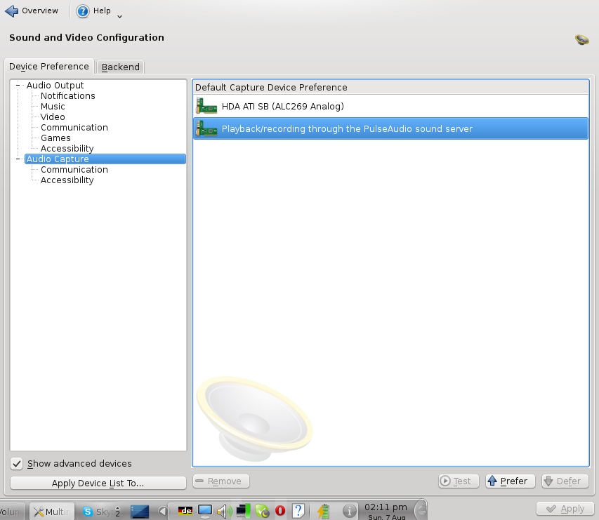

    Applications -> Settings -> System Settings -> Multimedia ->Audio Capture
    shows HDA ATI SB (ALC269 Analog)
    However, test is disallowed .
    A test is allowed if I go to Audio Output (not capture) and works fine.

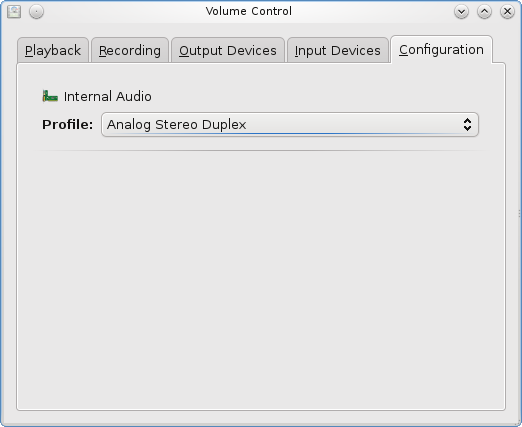

              Tried the procedure in the link -
              yes i can see how Capture in alsamixer changes when i move pavumixer:input devices
              In pavumixer:configuration I cannot follow the
              "Open pavucontrol, use the "Configuration" tab to confirm that both your onboard chip and your headset (or webcam, as applicable) are available. "
              as no devices are indicated - only "Profile" with "analog stereo duplex", "Analog stereo input", etc...

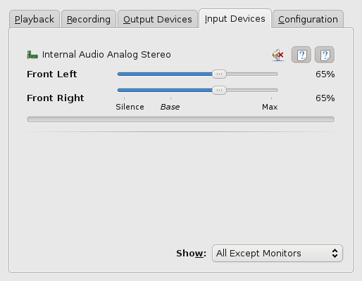

              In "input devices" I have two choices:
              Internal Audio analog stereo -> this one influences Capture in alsamixer
              Monitor of Internal Audio Analog Stereo -> no reaction to anything in alsamixer
              "set as fallback" option is not available
              "rear mic" and "rear mic boost" channels in alsamixer also do not exist...

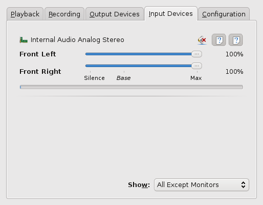

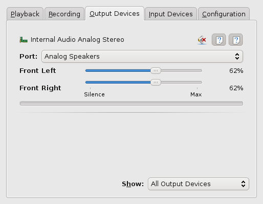

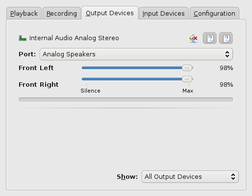

                      Step 2 -- open pavucontrol "Input", unmute the internal channel (because I had it muted to use the webcam), and turn up the volume:
                      [img width=400 height=318]http://img16.imageshack.us/img16/340/pavucontrol4.png[/img]
                      [img width=400 height=318]http://img841.imageshack.us/img841/8999/pavucontrol5.png[/img]

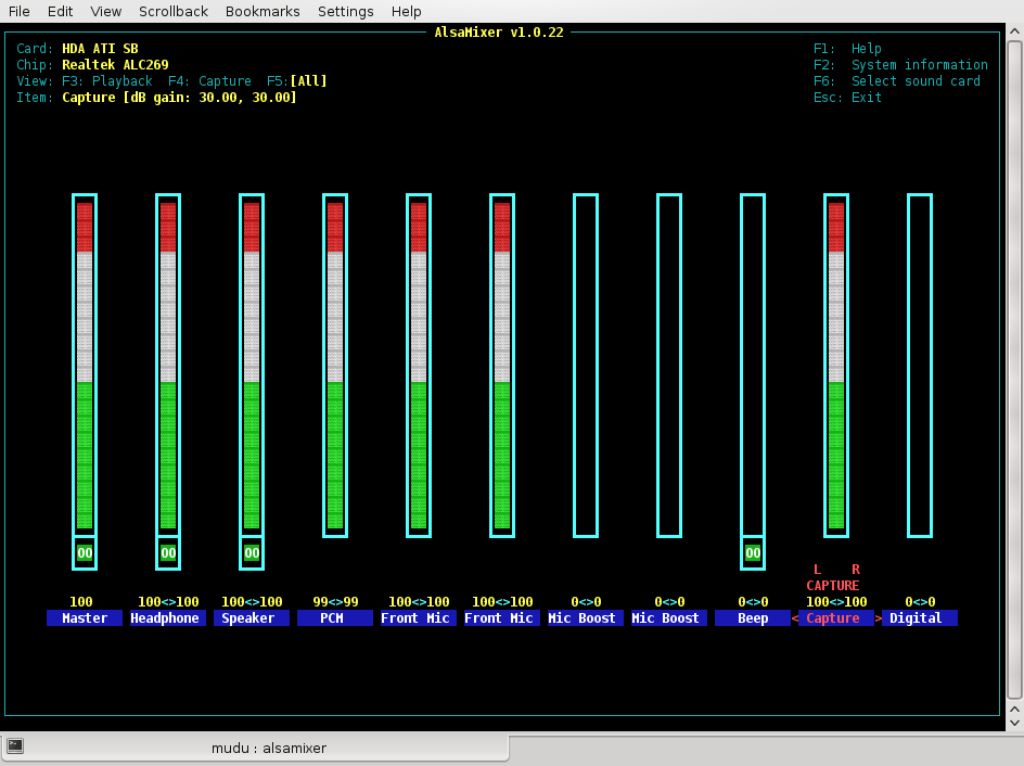

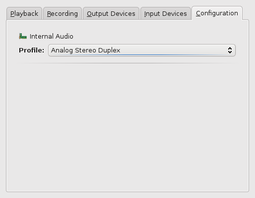

                        Re: Sound works but microphone does not
                        Thanx again for assistance. Still does not work
                        I put all the images down there to see the status.
                        Just to note

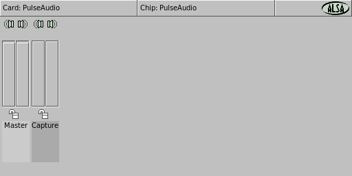

                        1)alsamixergui shows not much so I used alsamixer on terminal (screenshots down there)
                        2) in pavucontrol I have no panel 'ports' like it is visible in your case.
                        3) there is a built-in microphone in the laptop or I just plug in an old-fashioned headphone set with a small micrphone. In both cases no reaction.
                        4) after re-installation icons do not appear in pavucontrol...
                        5) system settings window as you see below does not allow any test for input...
                        i just got a feeling that somewhere the microphone is not recognized as it stands nowhere... It is strange cause the output works perfect.

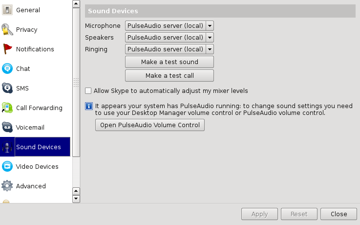

                            Your Skype setup and Systemsettings>Multimedia look correct. It must be an issue with the driver.
