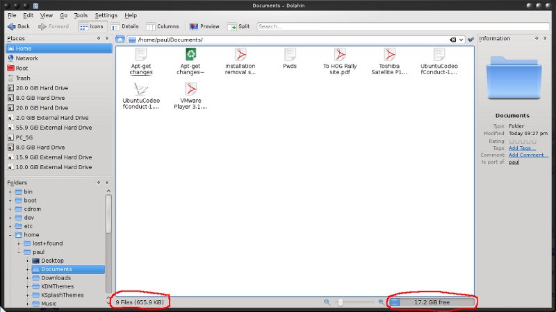

    Dolphin does show space available info, but you have to activate it.
    From Dolphin, click Settings > Configure Dolphin... > General > Status Bar and check Show space information and click Apply and then OK.
    To see individual file size information, just switch to Details view.

          With the change made the amount of free space available within any partition shown in Places is shown in the lower right. This really is the important piece of information you are concerned about. Folders them selves don't show 'size.' But once you click on one, the total number of files, and the total size of those files, is displayed on the bottom left.

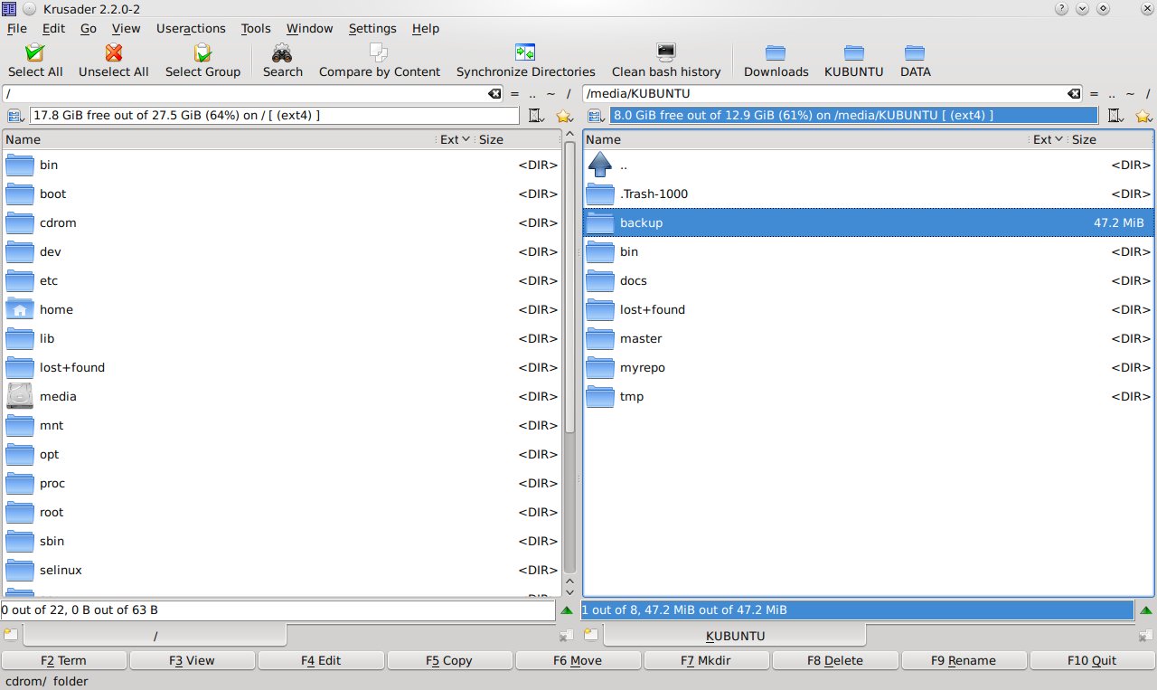

                              Take the red pill, and paste this into terminal:
                              sudo apt-get install krusader
