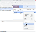

          No need to install Gnome's Disks if you don't want to. Use existing tools:
ID:	686693 Click image for larger version
