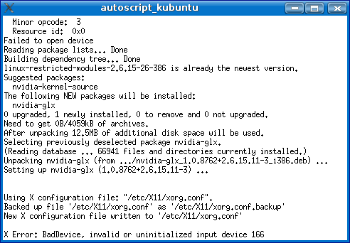

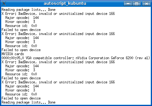

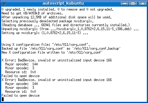

            Re: Yet Another Nvidia GLX Question
            Another failed install even after cleaning up. The automatix logs seem to tell the story. I just don't know the language. I'm also incuding the incriminating system settings screenshot.
