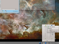

                  This is what I'm seeing when I play Amarok. No "Move" selection - and nothing happens when I right or left click on "Device Settings".
