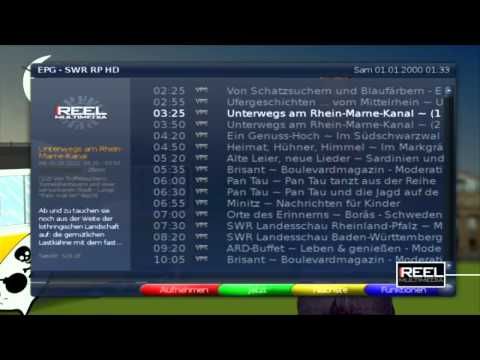

                        #56
                        @NickStone,
                        The htpc i`m using is this :
                        The video is in German i`m afraid , as the machine was built there. My Reelbox is version 2 , the video is showing version 3 but both are practically identical , barring software differences.
