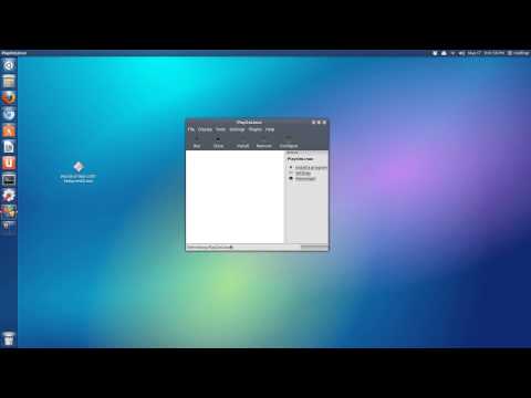

            Yeh, but it's working. Still don't get N speed though. In reality I don't seem to need the speed. Mostly just stream the TV shows I miss during the week and there aren't many of them. I was into WoW for a while... any way to get that working on a Linux system?
              Yes.
              http://www.wowwiki.com/World_of_Warc...nality_on_Wine
              That link give an alternate method of installing WoW using "PlayOnLinux"
              http://www.playonlinux.com/en/
              which is illustrated in this video:
