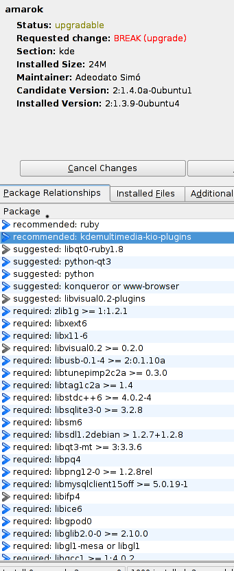

    I was trying to upgrade amarok to 1.4 and I added the required repository.
    I get a BREAK(cannot upgrade) error. This screenshot should show what packages I am missing. How do I install those missing packages. Thanks alot for anyone who helps

                    I think the problem would be that in your sources list, you only have multiverse enabled for the regular deb repository, but only universe enabled for the deb-src. The things needed by amaroK to upgrade to 1.4 are in the universe.
                    Change these two lines:
                    deb [url]http://us.archive.ubuntu.com/ubuntu/[/url] dapper multiverse
                    deb-src [url]http://us.archive.ubuntu.com/ubuntu/[/url] dapper universe
                    into these:
                    deb [url]http://us.archive.ubuntu.com/ubuntu/[/url] dapper universe multiverse
                    deb-src [url]http://us.archive.ubuntu.com/ubuntu/[/url] dapper universe multiverse
                    See if that helps.
